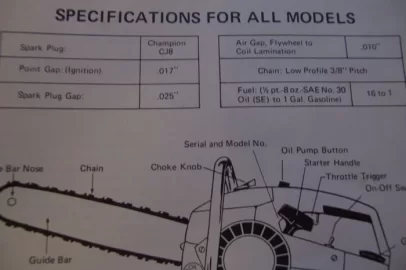

Don't know much about it, but a picture would expand my knowledge LOL :)
I have an old craftsman, 14" with a thumb operated oil pump ;)
[Hearth.com] Any one us a Homelite XL Top handle.
