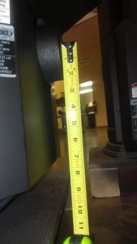

I measured 9" to the top of my stove's exhaust. 7" on center with a 4" pipe.

EstMtn, your stove with a c/l of 7" would work fine for me--pray tell--what stove is it?
Thanks
Piazzetta Sveva. The vacuum cleanout on my exhaust clears the floor by a few inches. Just enough to attach a vacuum nozzle.
