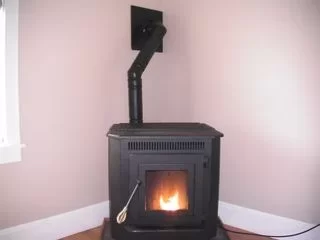

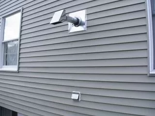

Hi Terry,
here is what I did. Used all the pieces of the dura vent kit plus a 45 degree elbow. Hope this helps.

sydney1963 that is a good looking install, would almost work for me but the one problem I am going to have is clearence to a window. I am going to have to close in one window with a plain piece of glass caulked and trimmed into place. Only other option would be to go streight up when I went outside but I really can't afford the 25 or so feet of pipe to go up over the roof. The house is a story and a half, top windows just 4 feet above the bottom ones. So If I go high enough to meet clearence on bottom window then won't have it on top bedroom window.

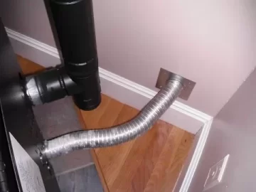

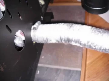

Here is what it looks like in the back of the stove. Spray painted the inside pipe with high temp stove paint. Extra 45 degree elbow cost me $35 and paint $12. We did do the install ourselves but it was pretty straight forward. Exactly 4' from end of vent cap to edge of opening window.
