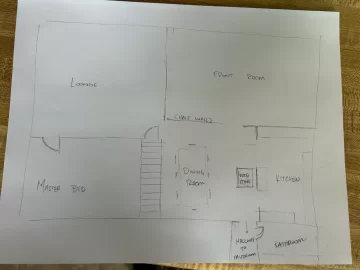

We are new to wood stoves - this is our second year with one. We live in South-East Wisconsin, and ideally would love to heat just with wood but have not been successful yet. We put in a Drolet 1800 last year and the stove heats the house fine with the temps are in the teens and 20s but not any colder than that. (We have the heat come on at 60, thermostat is in the living room). House was built in 1901, and probably needs new attic insulation, it currently has vermiculite and so we don’t go into the attic at all. House is about 2000 square feet, with the upstairs being about 700 square feet. I’ve attached a layout of the downstairs.
I have two questions.
1. What would be the best way to get heat to move more through the house? I’ve tried a fan in the living room pointing toward the stove and didnt notice any difference. There is a definite temperature drop in the living room and upstairs is really cold - probably 70+ in stove room, 60 in living room and 50 upstairs. Would a transom help? Wall vents with fans? I know some drop in temperature is to be expected, and perhaps the single doorway between the stove room and the living room is just too narrow to expect much heat movement. I expected the heat to naturally go upstairs.

Thanks for your reply! Right now stove top temperature is reading 450, that’s with the air intake wide open. Blowing insulation would be a good idea, I had wondered whether we could do that. Windows are new, double pane windows (except for one room), will have to check how to test if the sill plate is insulated.
I’m sure some of the problem is our wood, I don’t think it’s too wet but it’s free stuff we collected over the year from people getting rid of it so some of it was outside a long time and maybe is too old.
My bigger question though is how to move heat around the house - as the stove room will get plenty warm but the rest of the house is still cold

First think to remember, wood stoves are zone heaters. They heat the room they are in.
Being and older home, any air sealing/insulating you can do will help tremendously.
The Drolet 1800 may be a little undersized for your home. Bigger stove can put out more BTUs. Are you set on a stove or is a wood furnace an option? A furnace would get heat to all rooms of the house.

Welcome! We used to live just north of Milwaukee. Getting heat to disperse throughout the house is a challenge. Cold air is denser than warm air, so moving the fan to the farthest reaches you are trying to heat and pointing it towards the stove room will create a convective loop. Low fan settings will keep the lower cold air mass moving towards the stove from mixing with the warm upper air mass heading towards the fan. Insulation and air sealing is typically more important than replacing the stove.
