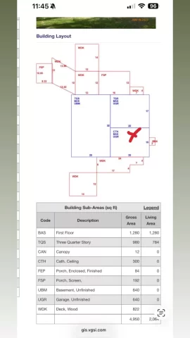

The freestanding stove is in the center of the house with vaulted ceiling ~22-23 feet high In the 300sqft living room, everywhere else is about 8 feet high, and above the stove is the 3/4 story living area. Total living area is about 2060 sqft. Home is well insulated and has two ceiling fans above the stove where the 3/4 upstairs living area is.

  • [Hearth.com] Woodstove decision/heating

@Jaison , thanks for including the floor plan. That helps me understand the three-quarter living space. Do you know if your relative has ever tried putting small floor fan on his balcony and blowing cooler air from the living space into the top of the cathedral ceiling there. You would think it wouldn't be too different from running ceiling fans in reverse, but it might be worth just trying it to see if there's a place it could be set up without impeding foot traffic.
I would not expect the BKs on low to satisfy the heat demand during prolonged cold, but what I'm trying to say is that even on low during moderate and recently some pretty severe cold they are capable of heating our 2,700 square feet of well-insulated space. If we ran them on a higher setting where we reloaded three times in twenty-four hours instead of only twice, we'd be putting that many more BTU's in the space. I think that just the larger firebox on a BK would be an improvement over the Oslo.
