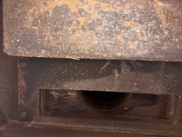

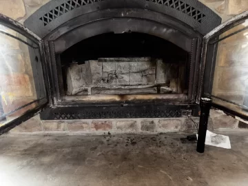

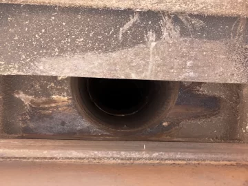

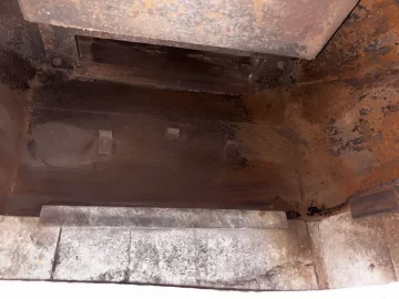

Hello,
I currently have a Fireplace Xtrordinair 44 Elite installed in the main living space in my home. This was installed by the previous owner of our home. Last winter, when it was very cold, the fireplace would only blow hot air out for a few seconds and then it would blow cool air. It had a hard time heating our home when outside temperature was below 20 degrees F. The way the fireplace is designed, it pulls outside air in and blows it around the firebox and out into the room once the firebox heats up to a certain temperature. I am not happy with the amount of wood this fireplace needs to keep the firebox hot.
I was thinking of putting a stand-alone woodstove in front of the fireplace and connecting the output to the existing chimney.
The existing chimney is 8" all the way to the roof. I also like the idea of having a stand-alone woodstove that does not require electricity for when the power goes out. Currently, if the power goes out , the blower on the Extordinair would not work, so heat output would be limited since there is no radiant heat from the fireplace. I was thinking that a rear vented woodstove, like a Jotul F500 might work in this situation. I could place the woodstove on the hearth and connect the exhaust from the back of the stove to the existing 8" chimney. I have attached photos of the current stove. The dampner plate blocking the current 8" piping shows 6 nuts, so it should be able to be removed to provide clear access to the chimney. Anyone perform a similar conversion? Thoughts on this? Thanks!

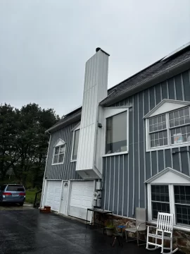

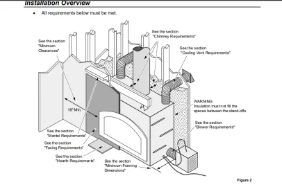

Thanks for your replies! The blower is on the outside of the house on the bottom of the fireplace chase shown in the first picture. This was done according to the installation instructions. Only in extreme northern climates, does the manual say to install the blower on the inside of the house. I've attached a pic for reference. The intake for the air intake of the stove is also on the outside (cold-air intake). These are located on the sides of the chimney chase. I wouldn't be able to re-locate the blower without disassembling the chimney chase. I actually just had this done 2 years ago due to a water leak and it was very $. The same would be if I decided to replace the fireplace with a new one. This has to be done from the outside of the house. The chimney chase would have to be opened up and the fireplace removed from the back of the house. The stonework in my living room would also have to be taken apart. I'm not looking for a big, expensive project. I would just like to know if venting a standard woodstove into the existing vent would work. I also like the idea of a standard woodstove that has a cooktop surface. That would be an added benefit of a standard woodstove.

Okay. Very inefficient way to do this.
Outside air intake for the firebox is fine.
If you go with a stove in front, that can be hooked up to the existing chimney if it's a class A pipe, or masonry - the latter would need an insulated liner in it, but that is possible with a 8" flue.

Thanks. Yes, the existing pipe is 8" triple wall Class A chimney pipe.

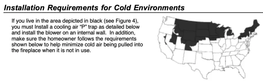

Exterior air supply for convection is optional. The convection blower can be supplied by exterior or interior air. In very cold climates interior air is recommended.

Thanks for everyone's input! If you mean by servicing, the gaskets checked and the chimney swept- yes. I'm not sure what else can be serviced. During very cold weather, the fireplace never seems to get hot enough to engage the bypass. The blower may blow for about 10 sec and then shut off since the cold air cools the firebox down so quickly. This unit was installed back in the 90's, so not sure if it has just hit its useable life. I really would like a traditional woodstove to use for the benefits mentioned above, so putting $ into repairing this stove is not something I would like to do. I am basically asking if it is possible to use the existing chimney pipe to vent a new stove placed in front of this one.
That explains it. Without engaging the bypass, most of the heat is heading up the chimney. It could be a dead catalyst if the wood is for certain fully seasoned and tested at below 20% moisture content.
