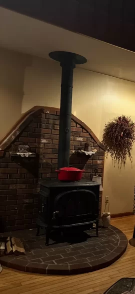

That aesthetic is nice. If the Woodstove looks good like that, and like his Jotul Oslo that would be best. It is the center of the room. But overnight burns are also the most important - he isn’t looking to feed it in the middle of the night to get some heat.
An Ashford would definitely burn with a nice steady heat overnight, but if it's the center of the room, does that mean that the back is visible? I've never seen one in person, so I'm no expert, but I seem to remember some discussion of the back of the Ashford being a little different, like maybe the cast iron cladding doesn't continue to the back. It would be worth taking a good look at that to be sure.
Back is not visible - the wood stove is just the first thing you see when you come into the house. Here’s a photo:

Thanks for the picture, and I can see why the Ashford was on the list. The cast iron look definitely suits the brick hearth and the decor. It's a lovely arrangement. Is what I think is a lamp just temporary? It looks close to the stove.

This picture was taken in the summer when it wasn’t operating. Nicest picture I have
