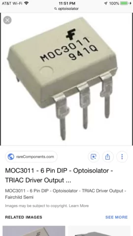

Never ever heard of an optical sensor circuit on an england stove,so I am in disbelief.If it exists,please forward me the wiring diagram.
Bob I think he means this
[Hearth.com] Anybody know who repairs Englander controllers? It triggers the triac
