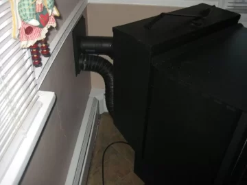

So today it's really windy here. Forecast said 20-25 mph gusting to 40. That doesn't sound that bad really but my place is slightly elevated with an open field to my west, so tends to be more windy here than most places. My large 18' high great room wall is creaking really bad so it's got to be at least that if not more here.
Anyhow I woke up this morning to a cool house. I had just been using the pellet stove overnight because yesterday evening it was 50F out and I really didn't want to bother with the wood stove or getting it going with a sluggish draft. Being really drafty I figured the house would be cooler than normal by morning, but when I came down stairs the pellet stove looked like it was barely going. And in fact while I was standing there it pretty much went out. I know in the past on windy days I had to turn the air setting down since my OAK is on the windward side of house and it seemed to burn the pellets down to nothing between cycles. Normally I have to have the air maxed out to get a better burn with my tall chimney and high esl. In the past on windy days when I see the fire burn down into the pot I turn the air back down to factory setting. Today that didn't help, actually it went completely out at one point and I pulled the burn pot out quick to verify - about a dozen fresh pellets in the bottom and just a bit of ash, maybe a teaspoon (I cleaned it last night). So I bottomed out the air setting and also cranking the fuel up. Still no real change. So I decided what the heck and pulled off the OAK and plugged it. After the fire got going again I reset controls to factory, then after another short while cranked the air back up to max again, and seems to be running normal now.
I guess the OAK is unregulated air, and it seems in my case almost like a supercharger in the wind since its in a covered porch that might act like an air scoop on the windward side of my house, on a knoll, across from an open field to the west. But I didn't have a whole lot of choice in the location since I was utilizing an existing hearth.

I only have that issue when running on the lowest setting when I don't need much heat and the fire is barely limping along. And it's not every time, just once in awhile. This only happens during those gusty spring or fall winds, since with any strong winter winds I'll be running the stove on a higher range anyway. Winds here are more like 40-60 mph or more off the lake.
I did attach a flexible air intake (saved from one of my old cars) to the OAK inlet, turned down, to help keep direct wind out of it. GF doesn't like it but eventually I'll come up with something better looking (the OAK of course). Since when it blows out the pot doesn't fill up, I'd like to make a circuit to restart the stove if the fire blows out and a thermostat or other switch is calling for it to be on.
It might be more than just a lean burn condition... I reconnected the oak this afternoon briefly. The stove went right out in a few minutes! But I noticed I wasn't hearing the tinkle of pellets dropping in. Is it possible the wind overcame the vacuum of the combustion blower and de-activated the vacuum switch? I suppose I should clean my glass so I could see for myself if the pellets where feeding instead of just sound. Unfortunately this stove doesn't keep the glass clean beyond the day you clean it.

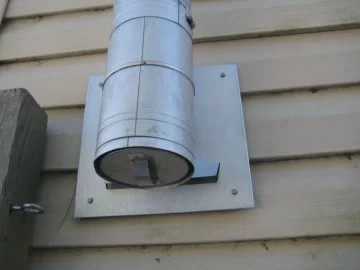

We have a lot of wind here, and my stove wall faces the wind. I've never had a wind-related problem, and my OAK inlet faces directly into the wind.
Same here.....no houses or any barriers from the wind on my OAK/exhaust side.
my Oak outlet from the stove goes up foot/half or more before going out thru the wall...
prob helps since it is Not directly out...Never had any wind problems.

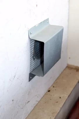

It's 3" outlet with hardware cloth and just a piece of sheet bent into a box shape overtop to protect from accidental porch furniture contact and stuff.
Mine is a lot more indirect than your, I have a horizontal 's' curve, well 3/4 of a 's' and very gently radius, the once it gets to the exterior wall a 90 up a couple feet and another 90 out.

No, you will only have to deal with it until you fix it. It can be fixed, we just have to get creative and find a way to govern the OAK air.
In the picture of your OAK cover, is it open at each end? If so, can you tape off one end and see if that helps?
I have a bunch of stuff on my porch that makes actually working on it a bit tough right now, but if I get a chance today I can try to see if it closing in partly helps.
