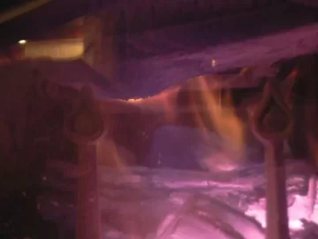

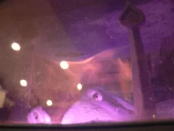

I just found this thread after realizing mine is severly warped. It has a hole in it. Stove in on its 4th winter. It generally runs between 400-550F on top. Is is not over-fired, and the damper is ususally set at .8 - 1.2 15 minutes after loading wood when the stove is warm. As you can see in the attached pic it actually developed a hole in the past couple weeks. Now the catylitic converter may be toast. I'll find out when the stove cools tomorrow.
I know how hot is has to be to melt cast iron, and I am very religious about watching the stove. I'm wondering if there is a different issue here.

I also saw your other post on this. Mine warped the first season and it always seemed like I had too much draft cuz I could still burn with plenty of flame at 0. Found out the air slide was off track in the back and was letting in too much air. I took a screw driver and pushed it back in place and it instantly made a huge difference. Or it could be you just got a bad piece of cast. That new stainless scoop should do much better from the looks of it. Also check all the other cast parts and gaskets, hopefully nothing else is damaged.
