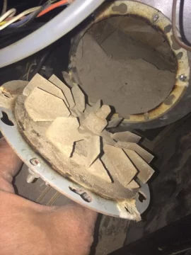

Here is a good case where the ash precipitates out of the venting side walls during the summer and stops the exhaust blower from turning and the stove from running!
New term - Summer Choke Down" ! ! !
See Pic Below. Impellers would not turn!

Even after a spring cleaning, it is possible that the high humidity during summer will make more ash fall off the vent walls. Even with a power driven brush, I am sure that not all the ash is being brushed from the vent walls.
I think I'm going to be doing both spring and fall cleaning in the future.

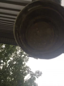

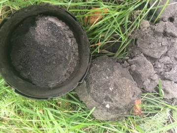

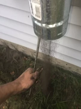

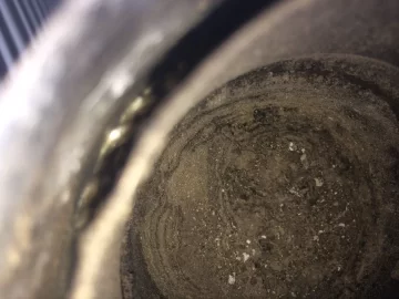

More Summer Choke Down venting!
Pipe is totally blocked! This is straight out then up 3 feet.
I have not seen this so much with inside up & out runs.

And they say wood stoves are dirtier......
Doesn't look like it was ever cleaned Wow
Awesome pics! Especially the last one of you clearing the obstruction (classic costanza boast from Seinfeld)
