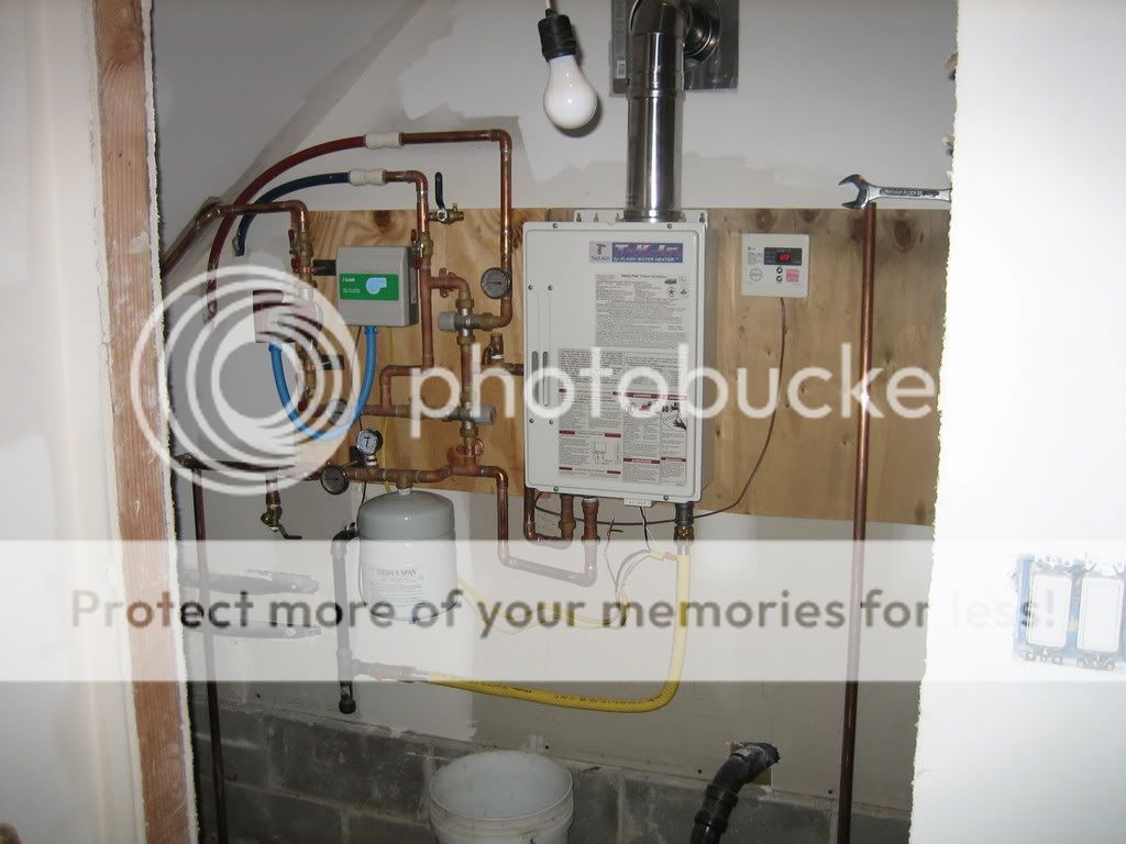

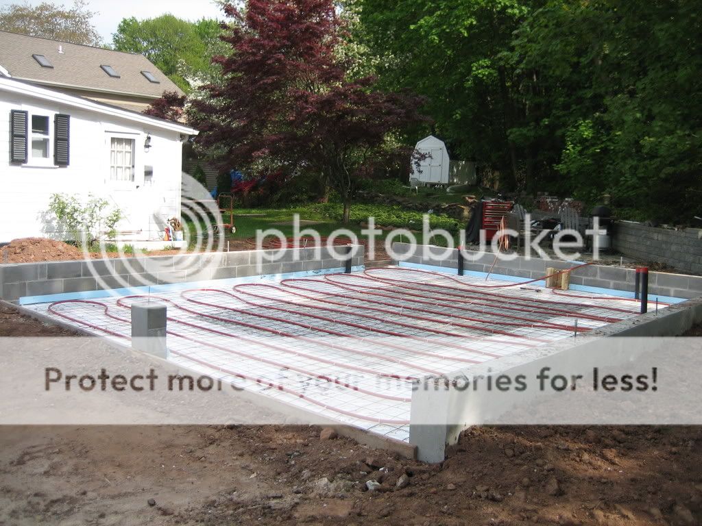

Radiant heat in concrete slab of ground floor of garage and pellet stove on the second floor. New 2x6 insulated construction means neither of them are running too much. A tankless water heater is used for my radiant heat and domestic hot water..
[Hearth.com] Anyone using pellet stove and in-floor radiant?
*wiring to heater was temporary at this time...now has a proper junction box/connection.

*below the middle section of the slab was intentionally left uninsulated to act as a heat sink and increase efficiency.
This is my nightmare .. full potable system .. no insulation in the middle ?? I put 2" under the whole floor of the basement and walls are a foam form R51 3" foam inside and outside of concrete...... best money I ever spent

Charlie500e
That small system heats both your house AND garage?? I have 1.25" piping from my 90,000btu boiler to my manifolds (4 of them), 2 pumps, etc. It fills out the corner of my garage, probably a 4x6ft area.
NATE379 said:
Charlie500e
No, just the garage...but the garage has a full bathroom, washer/dryer, and another sink that my Takagi Jr handles in addition to the radiant.
