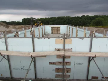

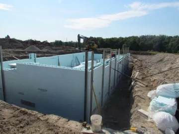

my icf foundation is two inches either side of 8" poured concrete, the basement is supper insulated. I built a timberframe on top and if i didn't have 22' sidewalls than i would have done all icf, but it was cost prohibitive so i went with sip panels. On the coldest windy days we have had i still feel some air infiltrion thru the sips must be in the corners.
  • [Hearth.com] Anyone with an ICF house and boiler?
