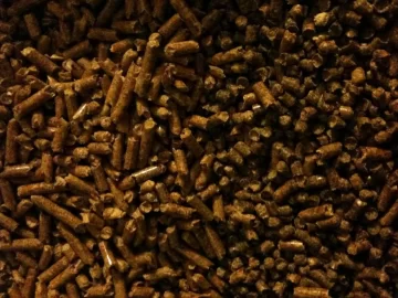

I am burning Starlights from TSC as well. I have had bags with the "long" pellets, but I me Englander stove likes them, burn nice and hot and very very little ash. The problem I am having is I have bags that all the pellets are like 1/4 to 1/2 inch long and they burn terrible. I can burn the long pellets all day and have very little ash, but the shorties fill the burnpot up with ash overnight. The long pellets are a light brown color, the shorties are usually green colored. I thought the first bag was just an oddity but I have several bags of the small ones. Anyone else seeing this same thing? I have attached a picture, the ones on the right are the shorties.
