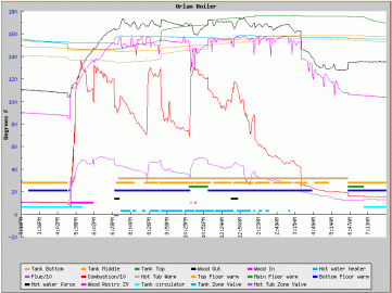

The graph below shows this pattern, with an extra load. The red line shows combustion temperature (divided by 10, so 120 is really 1200).
I started the fire at about 5:30. I came back at about 6:00 and added some wood - maybe half a firebox full. I'm burning poplar now, which doesn't last long.
At about 8:30 it had burned down to coals already, so I added another half load.
Finally, I loaded it to the gills at about 10:30. It burned out around 4:00 in the morning. At about 7:00 the system gave up on the boiler and switched over to heating from the tank.
I never opened it when there was any more than coals, and I never got any smoke out of it.
