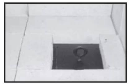

This is what the ash plug looks like.
[Hearth.com] 90s Napoleon 1100 - Ash door leak causing excessive wood consumption?
Reactions: Burnin Since 1991
No need to cut the brick. I think there is just a full-sized brick covering the plug area when there is no ashpan. Of course there is a plate there in that case so I would put a plate of 24 ga sheetmetal down first for better sealing before covering with the firebrick.
