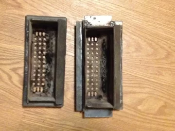

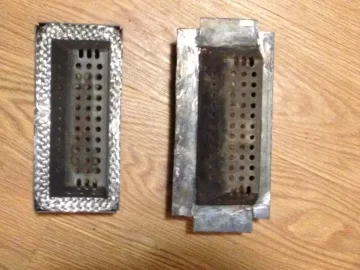

(Pictures -- above and below) Here are the two pots, the one on the left is the replacement that I got, the one on the right is the one I had repaired.

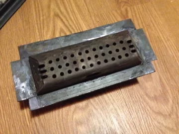

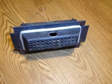

Below -- The repaired pot bottom view with new brim / lip.
[Hearth.com] Ashley AP5660L -- Original Burn Pot - Gasket Section Failed

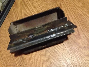

Below -- Back edge of the burn pot.

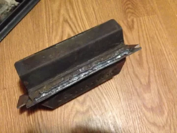

Below -- Front of burn pot.

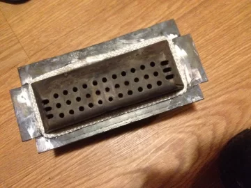

Below -- Gasket installed on the bottom of the pot to stop air leaks when placed in the cradle.

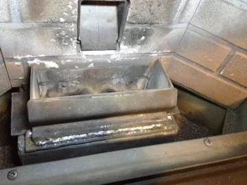

Below is the burn pot cradle.

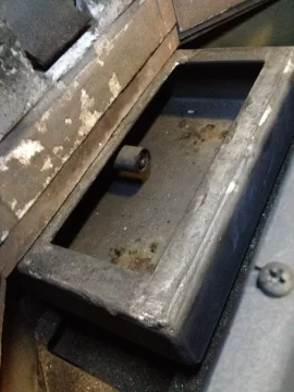

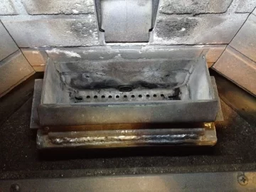

Burn pot sitting in cradle (above and below).
The repaired pot seems to be holding up well. As for the original pot, it has some flaws and needs to be addressed by US Stove.
I'll report back here with an update over the next week or two with info on how the repaired pot is holding up.

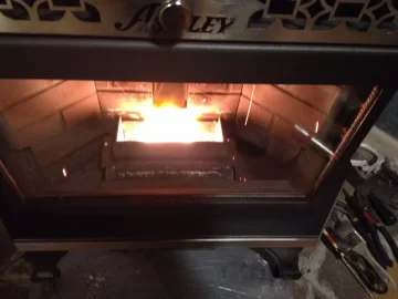

Fire in the pot....
