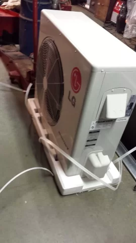

I can make you a chart I just got my 32,000 btu heat pump today...I got all the specs and its not the most efficient model.
