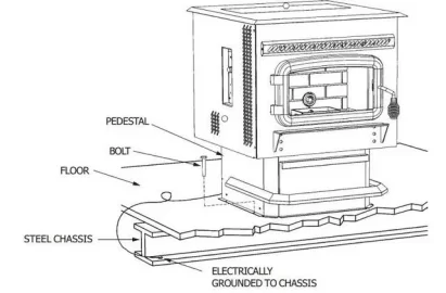

Most of the Install instructions for Mobile Homes are as follows.
MOBILE HOME INSTALLATION REQUIREMENTS
IN ADDITION TO THE STANDARD INSTALLATION INSTRUCTION, THE FOLLOWING
REQUIREMENTS ARE MANDATORY FOR INSTALLATION IN A MOBILE HOME:
WARNING
DO NOT INSTALL IN SLEEPING ROOM
1) Stove must be permanently bolted to the floor. Remove the Base Trim and bolt thru the base flange.
2) Stove must have permanent outside air source.
3) Stove must be permanently electrically ground to the steel chassis of the mobile home.
4) All vertical chimney vent must have wall supports.
5) All exhaust systems must have a spark arrestor.
According to the pictures I've seen you drill 2 holes thru the pad and the floor and run 2 bolts thru everything.

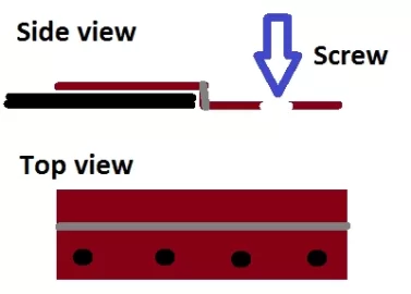

I am not sure this would be approved or look that good. But you could bolt this to the stove then bolt the other end to the floor on the side of the hearth pad?

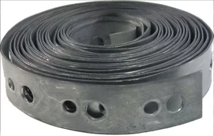

Maybe a metal plate with an offset? And some rubber under the offset where it touch the base plate of the stove.

Sorry for my drawing, you'll be happy to know that I am not an engineer :)

That may work if it would grab the heath and stove. I was just trying to avoid drilling thru the pad. Was hoping Craig would invent 40"x40" hearth pads with predrilled holes with matching plugs in them or something.
