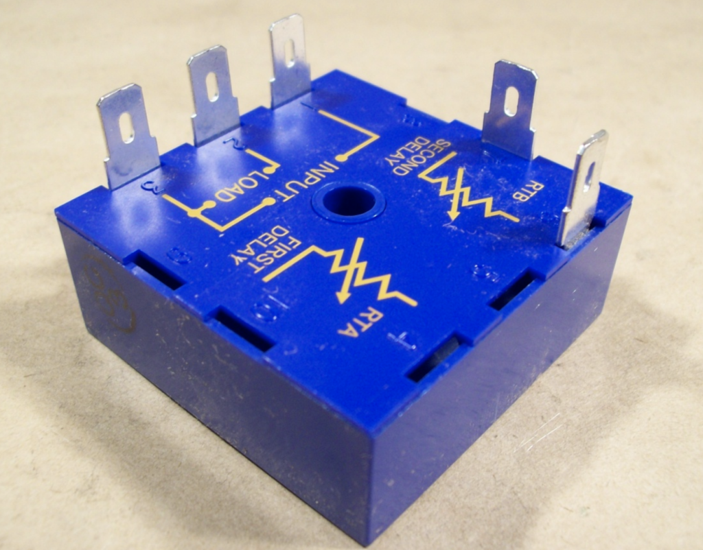

Any leads on where to get one of these? I contacted the only company I could find that had one. They want 90 USD set up fee, 90 USD for the part, and 60 USD shipping :/
[Hearth.com] Auger Constantly On
Looks
Have to figure out what you need it to do? Is that the one on your stove? If not any numbers on the one on the stove? Still think you should try the Potentiometer first not the timer.
https://oman-inc.com/cart/product/tgkad1010-010-ad1s2-airotronic-pellet-stove-cycle-timer/
With the potentiometer disconnected I still get a constant feed. If I meter across the terminals I have OL with it in the off position and a linear increase in resistance when I move the dial so I believe it's functioning as it should
