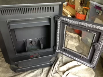

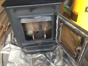

I have reburbished some real old rusty ones like the ones Mike throws away. :-)
Here is what I do.
25-PDVC Re-Do
https://www.hearth.com/talk/threads/englander-25-pdvc-redo.108354/#post-1420933
This stove had dirty augers with pokey little auger burrs, black carbon on the bottom auger, and dirty auger chutes.
See > https://www.hearth.com/talk/threads/...-little-auger-burs-pimp-my-auger-pics.102423/
Just from sitting in a damp garage, the exhaust blower housing was extremely rusted!
See > https://www.hearth.com/talk/threads/...-blower-exhuastion-and-a-little-rusty.108195/
After some Satin Black paint and a new room blower, the stove would not even fire up because the ignitor was WAY out of alignment
See >> https://www.hearth.com/talk/threads/...ellets-cap-on-or-cap-off.108321/#post-1420422
