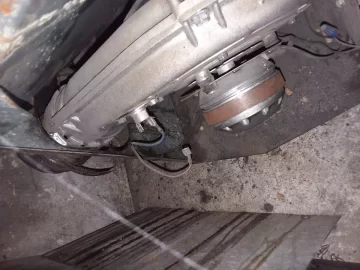

Ill try and jump out the low limit switch today,....see what happens. If that's not it I'll have to pull it out of the fireplace and check the tailpipe.

Well , this my have been the problem. The low limit switch on the flue fan housing. LOL
