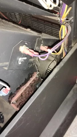

The 1200CB is usually a very reliable, no nonsense heater. The thermostat controls the unit's call light being activated. Once the call for heat, the control board starts the exhaust blower, ensures vacuum switch closes establishing vacuum. That allows the auger to start and feed its startup fuel. Ignitor comes on (told by control board to do so), ignition happens normally in 3-4 minutes with visual smoking first.
When TC senses 200 deg burnpot temp, it starts feeding pellets again, green light comes on on control board. When 600 deg burnpot temp is achieved the green light on board (200 deg achievement) turns to red. Once warm enough, convection blower comes on (typical cycle takes about 20-25 minutes). S1 is for convection blower, 110V is always present, careful! S2 is auger motor protection, S3 is overtemp/hopper fire protection. TC is obviously proof of fire indication. One thing that can cause a non specific unusual event is the control board has a poor connection on one of its terminals. Once temp is satisfied, call light goes off, pellets stop falling, convection blower runs until it cools down, S1 opens and shuts it off. Exhaust blower normally runs another 10 mins or so, then she shuts down.

Question- when was last full breakdown/cleaning? Weird scenarios, like working at times, not working at times for no reason are due to a stove being dirty. Has more than 2 tons been ran through this unit since the full exhaust path has been cleaned? The exhaust and convection motors have they been cleaned lately? I believe we checked the half moon on bottom of burn pot to make sure its properly working and is closed? BTW, is it normal for you to have to run your stove in July? Hot hot hot down this way...
Good you got it solved! Stay warm.
