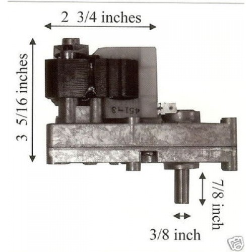

Found this one on Ebay of my exact motor, and it is a Berger Lahr and it costs $283 with free shipping. This is the exact motor that my local stove dealer wants $358 plus 6% tax.

The other one is $97 plus shipping but it is a look-a-like and not from Austria. Pictured below.

I dont think those are the same motors. Notice the exact replacement has 4 wires actually going into the motor. The 97$ motor will only have 2 wires. Is your stove a integra 2?
