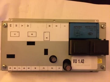

Anyway, I just got the motherboard firmware upgraded from version 1.33 to the current version 1.42
Also got some nice motherboard connector diagrams.

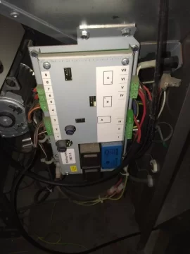

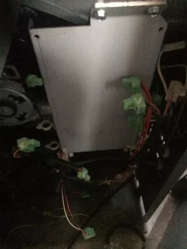

Ok, the flashed motherboard is in!

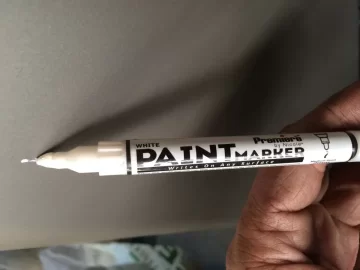

To make it easier I used a Paint pen purchased at a local craft store A.C. Moore.
Each plug was marked with the corresponding Roman Numeral or Western Arabic Numarals that are on the mother board see pic.

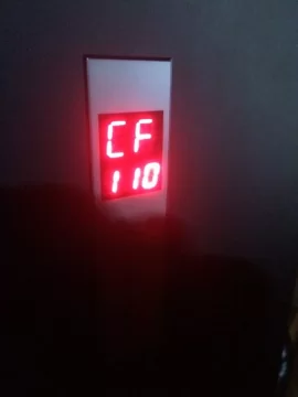

Now the convection fan can be adjusted in increments of 5 from full speed shown as CF100 down to CF150 which is almost off. See LED pan pic below that shows CF 110
