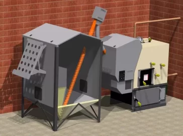

So then how are you planning on attaching the auger to the stove
  • [Hearth.com] automatic hopper feeding
I would recommend a capacitive proximity switch (not resistive: this does not work with wood pellets) and a timer relay that you can dial in the time of filling the pellets.
It will go through the side...see picture
