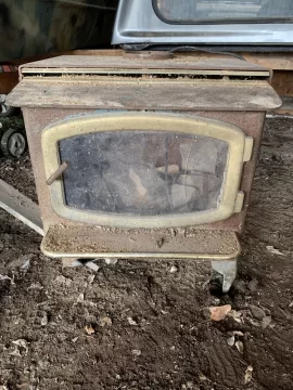

Hi, I am still rebuilding stoves but have not posted them in awhile but do check in and read now ant then. This one was a real challenge as you will see from the pictures. The first picture is the stove at the pickup location. The front leg left leg was bent back. He sold it for $20.00 and without my labor I put another $245.00 into this stove with new glass, bricks, gaskets, stainless steel, and ceramic blanket. But even then, if I was to keep it that would still be a great price for this nice of a wood stove.
I took off the outer shell in order to clean and paint all the surfaces. Bent back the leg and hammers the bend out of the metal then reinforced the metal to strengthen both front legs since I had it apart. I installed a new secondary burn system as this had one secondary burn tube at the edge of the baffle where the fire wraps around to the flu. The air was not preheated but came straight into the burn tube from holes on both sides of the stove. I installed square tubing in both back corners inside the stove so the incoming air could be preheated and then added two tubes one in the back and the other in the front. It works great. The baffle on this stove was bricks similar to what some other companies were doing during this time. I changed it to a stainless steel with 1-inch ceramic blanket. The fire turned out great and had some very nice secondary flames. Just sold this wood stove yesterday.
