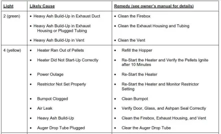

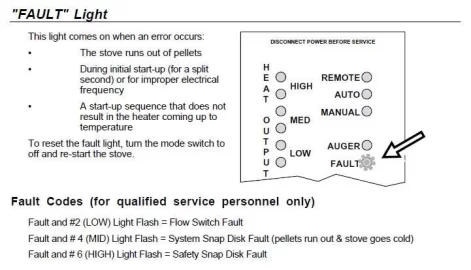

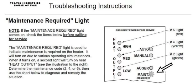

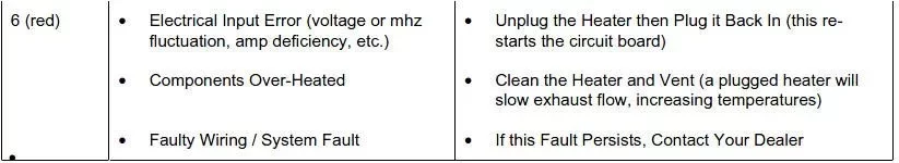

Hello
The Fault Lights have been changed to Maintenance Required lights on the new Travis Control boards!!
Therefore the old LED light under the "Auger On" LED light that was labeled "FAULT" is now labeled "Maint. Required"
So the new boards show user problems and fixes instead of failed parts.
Which light do you have on your Avalon Astoria Stove? If you have the old FAULT light then maybe a new control board would help alot because NO meters needed to troubleshoot!
See the difference in the pics below. The first pic shows the old control board fault light
