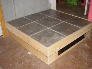

To the left and Below are pics of mine, so please post some pics of yours. Thanks.
I built a mantle and added candles and also built a hearth with some 2x4s and Tile on backerboard on plywood and added red rope light and a 220 volt kickspace heater to warm my feet when the stove is down for cleaning. LOL
