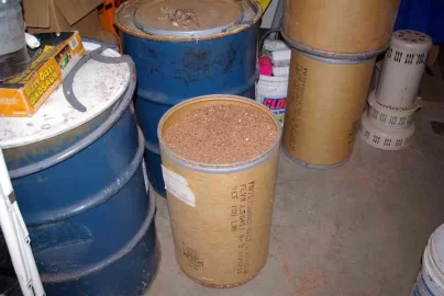

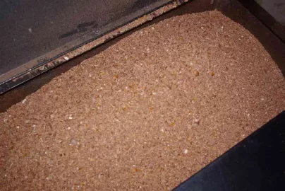

Yesterday I was filling the hoppers on the stoves with shells for the days burn and decided to snap a picture.
The material in this picture is a lot finer than I usually use but is representative of what I use to heat with.
One supplier runs all the waste materials out to the main silo where it goes through a trash fan and is blown into the silo.
The other processing plant runs the waste materials through a grinder before it goes to the silo.
The material shown is a lot more "meally" than what I really like.

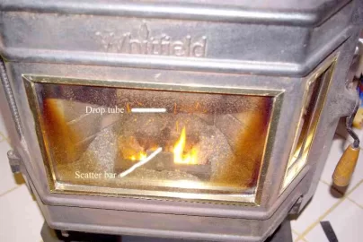

The Advantage really runs well on the fine materials without the need for daily cleaning of the fire pot.
The windows stay clean (as clean as they ever did on pellets) and the shells slide out nicely across the added "scatter bar" (I added to assist the material getting sewn across the fire)
Here is a Piccy of the hopper all nice and full and a piccy of the fire box with the fire in the low setting.
Usually we run this stove on the number 1 setting for most days.
This setting makes a nice warm fire and will maintain the room temp without the stove running at really high temps.
I use 2 for a quick warmup if the house is cold.
More than this builds a raging inferno .

thats super cool. do you ever get problems from the very fine material sorta leaking out of the auger and building up under the unit?
That is amazing! I thought my Omega would burn anything but something that fine probably wouldn't feed into the burnpot.
Thanks for sharing snowy! :-) I thinx pook is rather interested too. :cheese:
Usually get a dump truck full for Under $100
The stuff is very dry as the nuts were dried before they are cracked.
Never had any issues with leakage inside the stove.
Care must be taken when filling the stove as the stuff is dusty and will make a mess over time if one gets too fast with pouring the shells into the hopper.
I vacuum the inside of the stove cabinet twice a season just to keep things tidy.
I store the stuff in 50 gallon food grade steel barrels and anything else I can scrounge up during the winter.
I have many smaller cardboard drums with lids as well as some garbage cans with lids too.
The auger feeds the stuff great. The extra fly ash is the only downside.

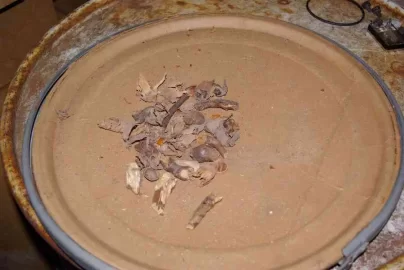

The only real danger to the stove is the fact that the stuff has sticks and twigs in it and MUST be screened before putting it in the stove.

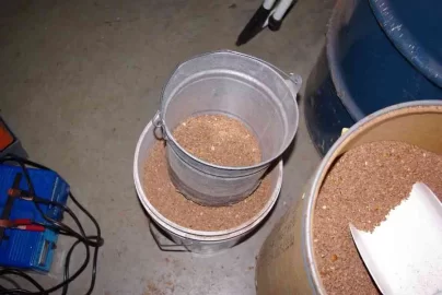

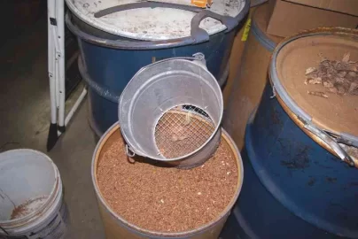

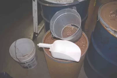

OK here are some pix or the storage and screening operation down in the dungeon.
You can see the JUNK in the one piccy that the screen caught. Some of that stuff would be fatal to the auger motor if it got stuck in there.
The steel "screen bucket goes in the 6 gallon pail and then I scoop the shells into that then shake the bucket gently to allow the stuff to fall through into the pail.
The finer stuff generally has less crap in it as everything went through the grinder first.
This is only a small area of barrel storage, I have a side storage room that has many many barrels.

Looking at your sifting bucket made me think that it works the opposite of my pellet screener. With pellets, the good stays on top of the screen and the fines and dust fall through. Link below.
Wonder if it would work for shells. Similar to your bucket, the good material would go through the screen and the leaves and twigs stay on top.

The screening bucket came into existance early on the first season we burned shells.
One cold winter morning about 2 am, I crawled out of the sack to visit the butt room and IT WAS COLD in the house.
I went out to the living room to investigate and found the stove COLD
Further poking around uncovered the fact that the feed cup (Earthstove two stage system) was jammed by a large stick about the size of ones thumb.
Sunday AM and no place open on Sunday either for parts.
Yanked the back off the stove and found the drive coupling laying in the cabinet in two pieces.
This was a small 3/8" cast iron coupler with a plastic piece between the two sections.
I had a brain Fart and stuck the halves back together as it had split right through the set screw hole.
I placed a stainless hose clamp around the thing and tightened it up.
Stove back running within a few minutes.
I left that thing that way for a couple years and eventually sold the house and to my knowledge its still that way. (Moved in 93) The folks that own the place now still use the stove.
SOOOOOOOOO
Later in the morning, off to the hardware store, bought that bucket, hacked the bottom out and pop riveted in a piece of hardware cloth with 3/8 mesh.
Been using it ever since.
Once I get into a barrel of shells a bit, I just toos it and the scoop inside and place the lid back on.
