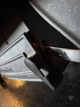

I have a Quadra-fire Castile that turns on and lights fine, flame is big, then goes out (firepot smoldering -picture), then drops pellets after 5-10mins, lights up again, then flame goes out… over and over. Blower stays on since it never really cools down enough to shut off.. This cycles every 5-10 minutes. Here’s what I’ve done:
  • Thorough deep clean as followed online video, including the removing blower for cleaning
  • Replaced thermocouple wire unit (no change) and confirmed seating is 1 inch over pot
  • Front door shuts tightly. I replaced with new OEM gasket (no difference)
  • Ash door has always been a bit loose, gasket looks good, but has never been an issue. I just give it a push after latching. I added a nut to latch to make it seal (no difference). Still door is a bit loose, but again has never been an issue. I did notice seeing flame through gap in ash door (see picture).
  • Tried 3 different brands of pellets. No difference

to me it sounds like its set for a thermostat and in on off mode, thermostat set at a point where it really cannot figure out where it needs to be. Someone been playing with the settings
Don't start throwing parts at it, a few test can narrow down what is wrong, very knowledgeable people on here willing to help. As zrock stated the place to start is Thermostat. Do you have one installed? Remove thermostat wires and replace with a wire between the two screws on back of stove this will illuminate the thermostat. Start stove is it still doing same thing? If now working it is bad thermostat or wire going to thermostat.
