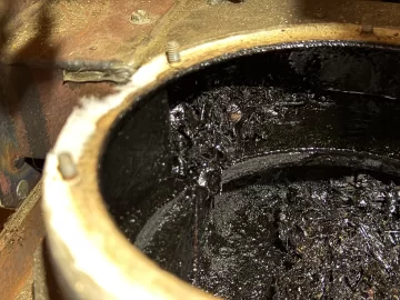

Took some time this morning and pulled the exhaust blower out. To say I think I found the problem, is an understatement. I am working on getting it all scraped clean and vacuumed out. The blower motor and fins are fine after cleaning them. Hard to see great from the pics but the opening where the exhaust was trying to flow through was about 3/4”, maybe 1”. The rest was all packed with the black creosote and debris. So no wonder why I didn’t get hardly any air flow through the stove.

I can assure you that stove is clogged up thick with ash, St Croix's are good heaters, but are difficult to really clean out. Yes the exhaust blower and housing need thorough cleaning, as does the convection blower. The self cleaning motor and linkage needs to be cleaned too and put back in properly. But the hardest part is the ash cleanouts in the back. After you take out the internal brick (most were metal frick frames), there are cleanout doors that you need to get a brush or a wire coat rack cleaner up and in to the top, tap on the back of the stove with a hammer and watch it rain dust... The tubes in the top are probably cruddy too, but airflow is definitely your issue. When cleaned up and a little TLC, you'll have a nice heater. Good news is you're on the right track. Oh yeah, keep the wiring straight- I used to put numbers on connectors that went together, easy to get one criss-crossed, and you know how I know this!
