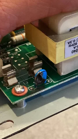

So I’m new to pellet stoves. Bought a baby countryside for what I thought was a good price. Still trying to figure it all out. Last nite we had a pretty bad wind storm and power went out. When I got home from work it was back on but stove would not start up. Found fuse blown in control panel. Replaced and it blew right away. Unplugged all connectors replaced fuse and nothing popped but panel would not turn on.
Bad panel ?
No surge suppressor?
Check the board for a burnt (Black, Dark Brown ) spot
This is what I found on control board
[Hearth.com] Baby countryside control panel
Yup, board took a hit... that blue part looks like a MOV.,,,Metal Oxide Varistor, supposed to protect board against voltage spikes..

Yeah unfortunately “POOF” done
can probly find that part on amazon or ebay and replace yourself with a soldering iron.
