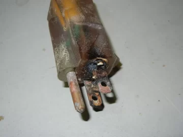

Picture of plug of the short extension cord feeding stoves UPS after surge-outage because of neighbor hitting transformer. Glad it didn't get into stove.

If the surge caused that then i feel sorry for the rest of the items in your house. It is very much worth putting in a tvss in home electrical panels at the main service entrance. Around $50 for a decent one. Can get the ones that wire directly onto the main lugs or a breaker style which is installed just like a 2 pole breaker for the most part. Worth every penny if it stops even 1 nasty surge. Hope all of your appliances etc faired well.

I am sure the only two things in the house not on a some kind of protection are the fridge and freezer. Will inquire about a whole house tvss this week. Forty foot plus digger connected to 400hp tractor probably didn't notice the removing of the ground transformer. The operator may have gotten a pretty good light show.
