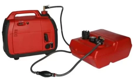

Ever since I moved from wood to pellets I have been concerned about winter power outages. I think you can live without most things in an outage but heat is a must. Borrowed a buddies Honda EU2000i last week during a wet snow outage here and with two extension cords we were running the stove and watching TV as the generator quietly purred outside the garage below my two sleeping toddlers. My wife was sold which gave me the green light to spend the $$$. Bought a six gallon extended run tank which is good for about 72 hours at full draw. I keep 4 five gallon gerry cans filled all the time so I’m not too worried about weathering a long outage. Would have liked a standby generator or at least a larger whole house unit but I opted for a simple turn key solution. Big $$$ generator + Transfer Switch + Electrician = Never Happens in my budget. The honda was a quick solution for under a grand. For those of you worried about a big north east ice storm I am sure it will never happen again now that I am prepared.
  • [Hearth.com] Backup Generator
Thats a nice little set-up you have there GroundHog. Never knew they had such a thing as an extended run tank, but it makes sense.
Only thing I'd suggest (if it's in the budget), is maybe getting a small manual transfer switch that can be wired into the house to run the stove and TV, etc, without having to run extension cords. Just fire the genny up, flip the switch...done!

Thanks macman, may go for a four circuit transfer switch in the future but for now it's extension cords. You must be able to run everything on that 12 Kw unit. I'm just shooting for basic survival.
When I redid the house and the wiring, I installed a manual transfer switch and a weatherproof plug on the outside of the house. I installed a plug in the electrical bay of my motorhome which is wired to my automatic transfer switch on my genny. I plug the cord into the motorhome then onto my house, switch my feed from the utility to the generator and start it up. It powers the whole house, burns 1 to 2 quarts of fuel an hour and has 75 gallons of fuel on board.
Last year, in my old house, it powered the house for over a week after an ice storm. Just an FYI for any of you who have a camper with a generator. I'ts an easy job for an electrician to make this happen.
