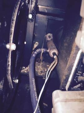

So upon taking the back off I checked to make sure that the vacuum hoses were connected which they were but the igniter was out of place.. I think I put it back where it belongs but stove still will not start.. I have added some pics to see if this is accurate.. Also I am wondering how I can bypass the switch until the new ones come in?

Toward the back of the stove are 2 round things with wires and hoses going to them. Looks like the item in the picture.
Disconnect the hose from the stove and suck on it. If it clicks then the switch is more than likely good. Hook it back up and disconnect the hose from the switch and blow thru it this will make sure it's not plugged with dirt.
