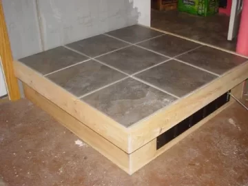

My stove is in the basement also. Therefore I built a raised hearth because I had water last spring. The hearth is a little over 9 inches high to keep the stove high and dry. See pic below
