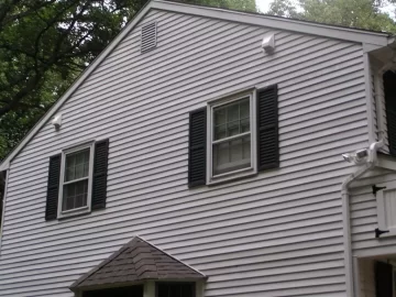

I was having the same issue with both of the bath exhaust fan vents when they were vented into the soffit area. I removed the 1X12 solid boards that were in the soffit and replace them with the Certainteed hidden vent vinyl soffit so I didn't want to vent the fans to the soffit area any more or through the roof as I really don't like anything coming out of the roof or making holes in it. I ran the new vent lines using the 4 inch thin wall ABS white drain pipe to the southern gable end of the house. The pipes come up from the fans on a 45 degree angle and use a 45 degree elbow to connect to the horizontal run that is pitched slightly to the gable wall to provide drainage to the out side of the house. There is a simple dryer type vent on the gable wall now. The pipes are uninsulated in the attic and have about a 20 foot run from the fan to the gable wall. They haven't froze yet this year.
