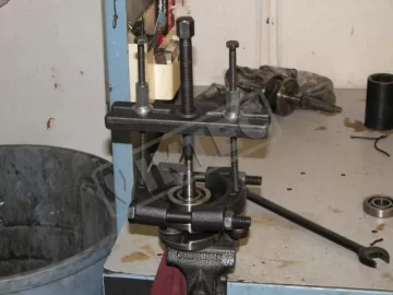

OP there are very small bearings splitters out there. Pictures are just for show and tell. The pictured puller works on bearings as small as 3/8 inch outside diameter. Why I use this type is I can use any length threaded rod to do any length shaft. My current convection motor has 10 inch long shafts on each end. A bit big? Yes, But does the job with literal ease and I already owned it!

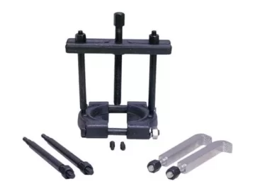

Pretty sure harbor frieght has the mini bearing splitter for less than $10 and the puller is pretty cheap.
Here is what I found online, But a local store may have smaller.
http://www.harborfreight.com/bearing-separator-and-puller-set-93980.html
