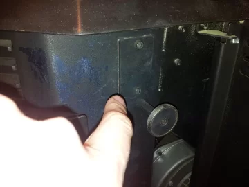

Open the side panels. There are latches on each side of ash pan. Unlock and slide it out. 2 round covers on back wall. Real men don't read stove manuals
Are you sure that's for the pi40? not the ps40?
I've been through my manual 100 times cover to cover and have never seen that.
the sides open to 2 per side square flu passages, top and bottom. There are no latches. im pointing to the top 1. i clean these every time i clean the pipe. and i can kinda get into them from inside the burn box with my straw tool on the vac and i sniff around for loose stuff at the top every time i clean the ash pan.
I tried to snap a few pics of the back of the stove, but there's nothing but sheet metal coming out in them.

Yes you are right. Didn't realize you had an insert. My humblest apologies
