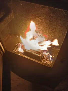

SPoke too soon errrrrrrr. I got 4.5 tons of new to me pellets this year and my harmon is burning perfect. Yet this stove, even after this good cleaning, Im still wasting pellets. Build up in the pot. Seems to dump alot of pellets every cycle. cycles ALOT.... It wasnt like this before so im perplexed. I cleaned the pot last night when i got home so shut it down....cleaned and re fired. took a while to fire but when it did....it really huffed hard! blew a big puff of smoke out through either the door or the blower vent where the hot air comes from. I couldnt tell as I wasnt near it but i sure heard it! Any suggestions please?

I think I'd check the chimney again.

these stoves are designed different for sure. The exhaust is under the ash pan. i can see where it would take ALOT of cleaning constanly. Just weird its been causing me grief this season . I thought for sure it would be the new pellets and they were junk. but once i fired up my other stove down stairs...zero issues with it. Ill look again at chimney
What are you’re settings at?
Leaf blower time!
I wish it was that easy. Its been 4 degree here for a few days. Im old and cant climb that roof in the summer let alone the ice covered rood now. Do the best i can from the inside. Maybe i can rig the leaf blower to my T clean out and blow it out that way
Reactions: ARC
Try running hot for an hour or so, I’ll run minP61a HARMAN at 4 and 4 on stove temp for at least an hour once a week minimum and it helps keep everything open and breathing well. Could you post a photo of your setup? Exhaust piping height etc.

im running this castle serinity on manual. mostly on level 1 in the early season.....and IF its really cold with my p68 running downstairs . on level one as well. running both on low, one down one up...seems to keep the house pretty comfortable. i rarely run the castle on any higher than one by itself.

Fair warning, running any Pelletstove on low constantly will cause build up in the burn chamber and the exhaust…that’s why my suggestion of running the P68 on 4 and 4 occasionally…keep us posted

Thank you for the advice I guess i just need to keep up on the cleaning more often if im going to keep them on low. With the price of pellots in my area...i cant imagine how many id go through if i ran both on med or high?

And that is why most of us say the Harman's will eat just about anything without any fuss.
The Castle seems to be unhappy with the pellets. I assume you have tried adjusting the draft? I know the drop-pellet stove that I had, a St. Croix Hastings, was very picky on draft and if I changed pellets I had to go thru the process all over again.

ill have to look into the manual about that.....im not familiar with changing that or that i could THank you.
