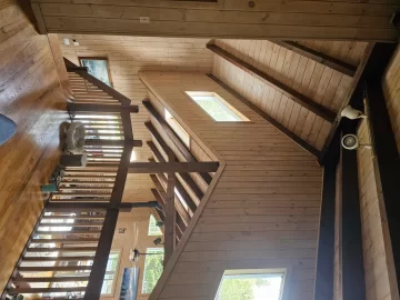

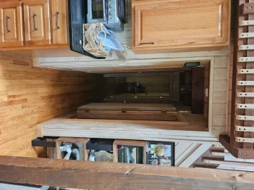

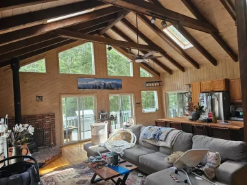

looking to determine witch pellet stove i should add to my basement, right now i am between Harmon Accentra, XXV, P63 or Quad fire Mt Vernon
last winter i tried to heat my house with just Hearthstone Heritage (only alternative for me is currently electric Baseboard $$$), it did a decent job but heat failed to get to rooms on the further side of the house (we were fine with the rooms being cold but had a son in June so now we need to heat at least one of the rooms) and obviously Basement was just above freezing to prevent pipes freezing (added a gym this summer so will also need heat down there). my house is around 1900 square feet not including Basement, however we have 18foot cathedral ceilings in the main living area as well as up on the loft where out bedroom is, lots of volume. so im looking to add a pellet stove to the basement to help with heating the rooms and keeping up with all the house volume on those bitter days. the stairs to the basement are located next to the doors for the rooms, looking for ideas on what size pellet stove i would need, again thinking between the Harmon Accentra, XXV, P63 or Quad fire Mt Vernon.
added some phots for context of home layout

Either a Harman P68 or an Enviro Maxx. Then figure out how to move the heat around.
It really depends on size of basement, whether it is insulated, and how well heat actually rises up the stairs.
