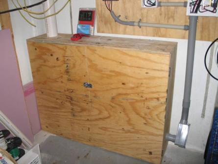

here's a few images I pulled off google for some homemade solutions.
[Hearth.com] Best/most economical way to run stove during power outage?
And that's for a bank. again, 1 probably won't kill you.
Just if you can, charge it in the garage, not inside and you should be fine.
