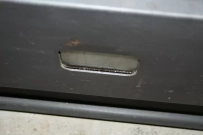

Have a big E....that just refuses to light without some assistance. It has a 3" exhaust on it that is a bit long, according to the calculations, if that matters. It will not light if you rely on just the ignitor. I have to either put a paper towel beneath the burn pot or throw a few pellets in the pot and hit them an ignitor fluid, light them and keep my toes crossed that it will light. Have always wondered about the ignitor being so far away from the burn pot, but the place I got it from assured me that is not an issue.....

Test the ignitor? What is involved in doing so? I do know that it is trying to do its thing....it does make the burn pot hot...and if I stick a sheet of paper towel under the bucket it does burn the paper towel. Will check the tube for obstructions. How can you tell if the door gaskets are leaking? Will shutting the dampner entirely help it. I have it pulled out about 3/8" or so.....seems to burn best on #2/3 at that spot. Have always wondered about the small air gap above/below the door. Would like to thank you folks for your suggestions.....

find out what style igniter you have. then find the specs and test it using ohms. also you could confirm you are getting full voltage to it, it is not common but does happen.
