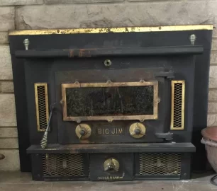

Hello everyone. Does anyone have any info on "Big Jim" fireplace inserts or wood stoves. I found an insert locally listed as a Big Jim, and it caught my interest. I wondering if Big Jim was the manufacturer, or just the model. Opinions/experience with them would be great. Anyone have dimensions or any old literature?

Looks like a big slammer style insert. Low efficiency by today's standard. It could be hard to vent properly. Some of these old boys had odd flue outlets.

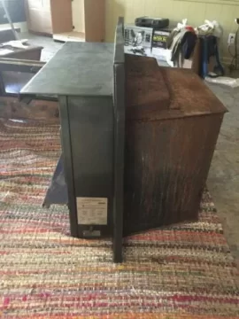

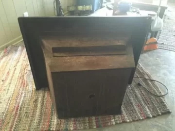

Evidently the damper opens a rectangular slot for an outlet. I'm guessing finding an adapter for something like this would probably be a make it yourself situation?

Yes, it look like that back narrow vertical piece must connect to a damper. I don't like that. It seems very dangerous if a person or child inadvertently closed that while there were still hot coals in the firebox. This is not the way a typical bypass would work. Yes, to make this work a custom transition piece would have to be made. Not sure how well one could seal it or how it would perform.
I'd pass on this insert. There are much better performing modern inserts that will put out more heat with less fuel used and they'll burn much cleaner.
