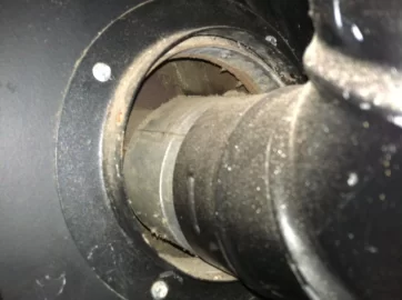

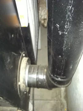

Ok. I have a new seal coming but I looked at the back of the stove to see how the pipe was attached. They have a DURAVENT pipe hooked up. It's not the Bixby Designed pipe thats 5" outer with 3" inner. Will this DURAVENT piping also effect the function?
That seal is essential. I also bought a used Bixby and our stove ran like crap until we got a lew one. Google Blume Ebay and message him on there. Get his # and ask him to buy a loop seal. I think he sells them for $14. You'll need to drill holes in your plate but it's easy.
Good luck

If the stove hopper seal is gone the stove is getting to much air without it going thru the pot and screwing up the temp probe sensor readings too. The seal is a major improvement over the original. The stove can operate with using duraleak as pictured IMO. Your just drawing air in from the inside of the home. That pipe design of Bixby is one reason for the stoves very high efficiency.
I think your getting closer.
Yup, you need that seal. You can purchase high temp high silicone content 1/8" thick sheets, and cut multiples. I got a year from the original seal w/ pellets. My dealer had me test the seal using a high silicone high temp material he found, vs the Bixby standard, and that one was good for 3 years. Used it as the flat seal vs loop.
Your exh temp probe would be my first guess. If you bend that rigid brown wire right it willstay connected to the board. Make sure it is connected to the large board and not the smaller igniter board. There is a place it will fit on the igniter board but it doesn't belong there.
It can be jarred loose very easy and the stove will start great but if that probe is not hooked up to the board it will drop to a idle then go out because the sensor didn't read a temp rise. The other solution could be that a thermostat was used before and disconnected. Then somebody failed to connected a wire which should connect both screws used to connect the thermostat.
Your exh is not a problem. That is how I connect most of the Bixbys I use. In fact if you notice under the exh pipe is a hole about 3 inches in diameter. It has a cap covering it. You can remove the cover then remove that furnace filter in back of the stove. You should see a black flex hose about 3 inches in diameter. You can re route that hose until it sticks out the hole under the exhaust and connect it to a outside fresh air source which is better then using the hot air your stove produced
I could include that double pipe design is a double edged sword. The advantage is to prewarm the incoming air. This is fine for a short length of pipe but I have seen many examples of a basement install with long exh runs and the pipe only lasts one year before it is rusted and leaking. The reason is the cold air surrounding the inner pipe cools off the exh gases and then the soot drops and lays in the pipe causing rust and holes. When that happens the exh gets sucked into the incoming fresh air which is supposed to furnish oxygen for the flame resulting in very poor performance of the stove. This has happened many times. That is why I say if you can keep the two systems separate the stove will work better and save you the pipe expense.
