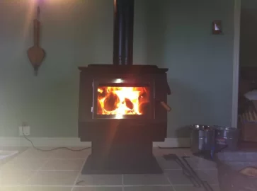

Just got my new princess ultra installed and it seems to work great! But Id like some info/advice from some seasoned pros on the best re loading and burning practices. Like im told i need to crank it up once a day to get er good and hot to burn the crud out, but how long should this take and whats the best way to do it..? Also for re loading, i open the bypass and wait a few min before opeing the door. But after loading can i just close the door and bypass and walk away, or...? And when re loading, iv heard rake the coals to the front and load North-S, East-w... Im just looking for some tips to get the most out of this little heater, any input would be appreciated. Thanks
I'm not a BK seasoned pro yet but this is the way I've been doing it which is pretty similar to my prior cat stoves. Rake the coals forward, fill the stove up full, burn with the bypass open for about 10-15 minutes at a higher setting like 2-3, engage the cat and continue to burn hot for another 10-15 minutes, then turn the t-stat down to desired setting. I've been burning pretty much at 1.5 so far during the shoulder season and it gives me consistant 24 hour burns with good dry hardwood.
Oh, and as far as reloads go I like to place the first row of splits E/W then the top row N/S mostly because the coal bed raked forward leaves a good pile up front and it's just easier for me to tuck the first row E/W back behind the coals.

Wow you fellas are full of knowledge! Im going to let the stove go out tonight and give a look over tomorrow when it cools down. So far i really love this stove. It is what they claim, set it and forget it!
