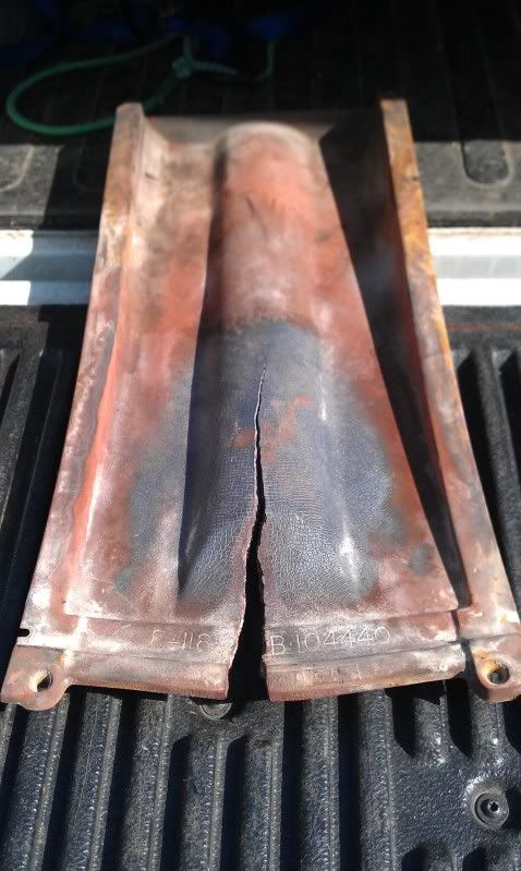

My 5 year old stove had some issues last year and the top baffle cracked. I have the replacement parts and started the reassembly. I'm dry fitting the secondary air tubes and all I can say is wow, what a strange design. The clips seem odd and they don't seem to hold much. I have serched here and found some info but could use a few inside pictures of the front tube and the exact placement of the clips and air tubes.
Any other tips or tricks to getting this back together would be great. I have 2 tubes of furnace cement, gaskets and a ratchet strap.

I showed the local dealer, he emaild some pictures to Jotul and they said I over fired the stove. Never saw anything above 500F. I think this design is flawed. My first and last Jotul. I'll make it through this year and do something different next year.
Both side plates were cracked as well. I had a steel stove from the the big box store before this-it's working fine to this day next door.
If I recall correctly, there have been several others that have had problems with the newer 118.
It looks to be real problem. The more I hear/read the more pi$$ed I get.

At the end of last season I had a strange crack in my F500 top. I did the same thing as you with pictures and went to my dealer. Their original thought was overfiring but I argued that I had not. I brought in the top and the jotul rep stopped in to see it. It was determined to be a bad cast around the oval.
If you say you have not overfired your stove and its still under the 5yr warranty, continue to argue your case.
