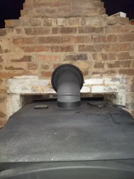

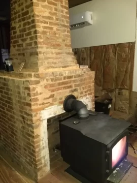

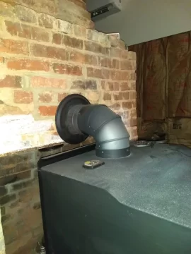

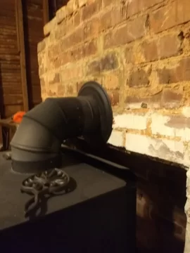

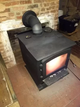

Would still like pictures to see your situation to make sure its your best option, and because I am a 30 owner and like to look at them.
OK, thanks. The house is being renovated so it looks rough. [Hearth.com] Black Single Wall Pipe Recommendation

That stove top temperature should be in the middle of the step in front of the collar. ````````\____ right on the that sloped part.
I have that corrugated elbow and it hasn't been too bad to clean, but mine is 18" from the stove outlet and generally gets run hot. The Selkirk pipe feels a lot sturdier than the durablack 24 guage stuff that I can find locally.
