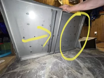

The improvements provided by the KE40 have been clouded by a problem I cannot ignore! The fire box and ultra base are a dangerous combination! The movement and deflection of the stove body, under normal use, is unbelievable! (See videos) Throughout my first winter use I was scratching my head every time I opened the door and put a piece of wood in. The stove wobbled upon opening the door and loading wood. In the past I would always keep a large pot of water on the stove to add moisture to the dry air. I was unable to do that as it would spill onto the wood stove, upon opening the door and loading. This is also another safety hazard that should not be ignored. Water on the glass door could easily cause a glass breakage that would lead to a runaway fire and other massive problem!

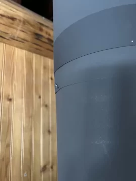

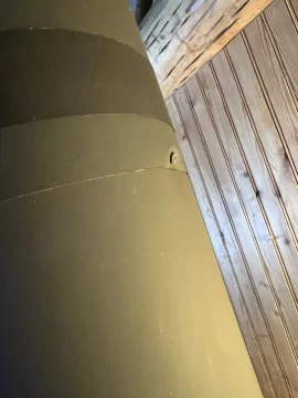

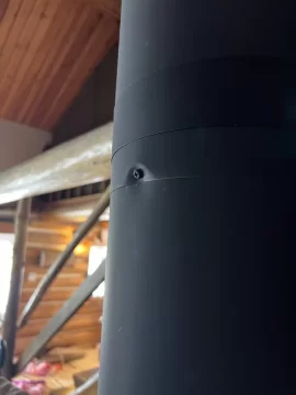

The flaws in the stove translate movement 15’ to my ceiling. This causes stress on every pipe seam screw. This double wall stainless pipe is not cheap and I’m experiencing wallowing out of the screw holes. It also causes unnecessary stress on the cathedral box. My largest concern is safety, the possibility of stove pipe failure, smoke filled house, or fire. It appears body of the stove was not properly engineered to support itself where the ultra pedestal attaches. In addition, there is noticeable movement in the base as well.

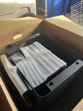

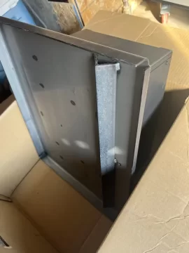

I’m entering my third winter with the stove and no acceptable fix to the problem. I have been provided a new ultra base, which was even worse than the first, as it was with out a major support piece that was present on the first base. (See photo) I was also offered parlor legs and the ash box to go with it. The parlor legs would likely improve the problem. But, why are they selling their best, most expensive, king combination in a system that does not work safely or acceptably?

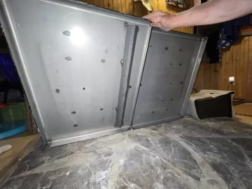

There is actually no real top to the base/pedestal. It just has a small flange that attaches to the stove. There is definitely some flex in the pedestal but it is more at the lower portion. I believe most of the flex to be in the bottom plate of the stove itself.
This was actually the original bass that came with the stove. They offered me a new one thinking it would solve the problem despite my attempts to explain what was really happening

I really think it's an issue with the bottom of the stove body not the pedestal. Did a dealer install it?

I agree! it’s definitely more at the bottom of the stove, but the pedestal does not help. The pedestal was under engineered to begin with. In addition, it looks like they have an even cheaper version they made, which is what they sent as a replacement in their weak attempt to make the problem better. The problem was measurably worse.

Literally all it would take is a couple small support joists between the outer shell and the inner shell of the stove box , where the pedestal attaches to the base of the stove

The shear on the pipe would result in an unsafe situation, over time, even if the stove itself can withstand the shaking.

I guess I beg to differ on the safety aspect. The 15’ run of stove pipe wiggles like a noodle. If left alone, it would not take long for more damage to occur on each screw of every pipe joint.
In addition, I don’t think it’s easy on the cathedral box at the ceiling.

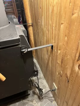

I came up with this solution in efforts to improve the problem and not void my warranty. The bracket uses a factory heat shield screw. It makes the problem about 75% better.
